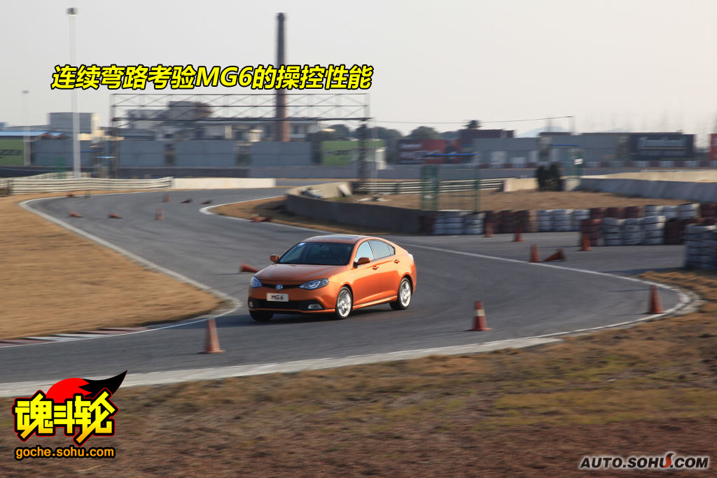

    Followed by continuous detours and bumpy roads is a major test for the MG6 suspension tuning, and also able to integrate the car's handling performance, see how in the end. Tianma Circuit, some 180-degree back bend in this section do not take the speed down to an appropriate value, the former driving the phenomenon is bound to produce the Tuitou, ESP in this case can not be too much for help. You can only slam the brakes continue to reduce the speed and steering wheel, dead to want to go the direction of, the body will follow back to positive.
    It is worth mentioning that, MG6 chassis style is really out and out racing-oriented, even if there is an unavoidable Tuitou phenomenon, body roll is also not obvious, you do not have the first effort to "come back to" their body. In the ensuing continuous detour medium speed though have reached 50-60km / h, you still do not feel much of the roll.
    With the horizontal stabilizer bars Multi-link independent rear suspension and 215mm of the limited capabilities played a role at this time, tough to adjust the style of the movement in full compliance with MG6 location. At the same time, you do not have to worry about the rear would be disobedient held back because it is very close to the shape of the rear hatchback, that is, "without rear impact."

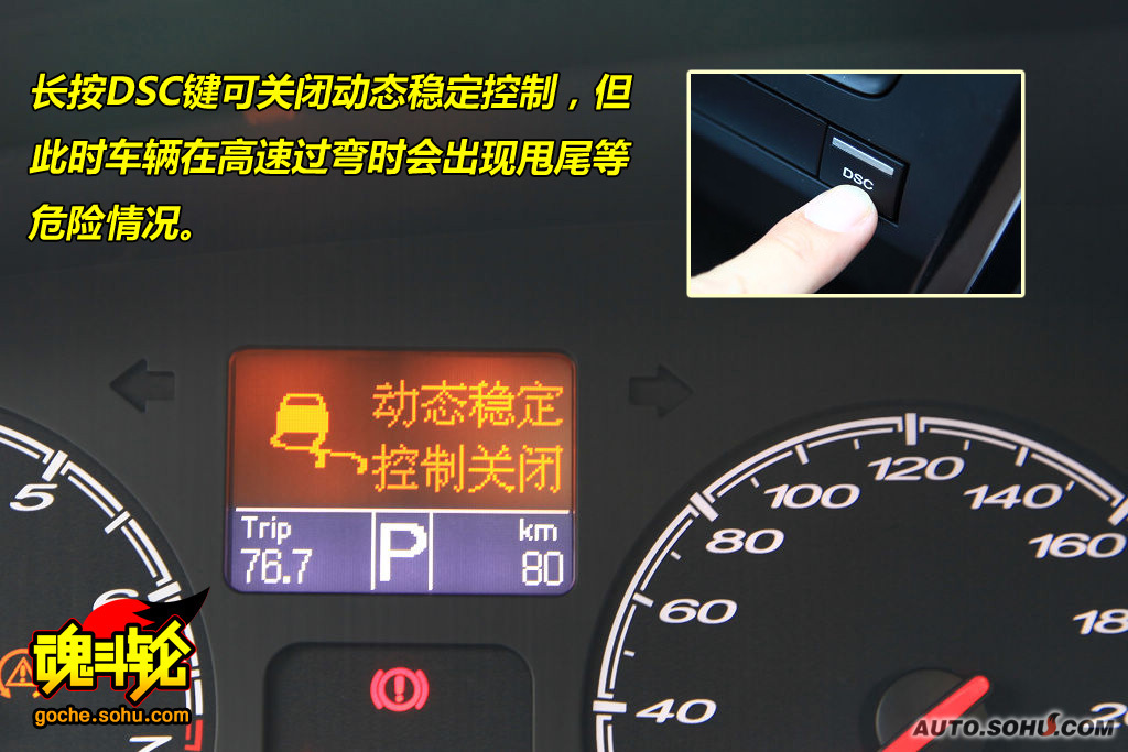

    Of course, with the DSC completely shut down, the tail flick phenomenon in the corners on the heels of a very dangerous, we can see that in responding to emergency situations DSC's role will be very great.

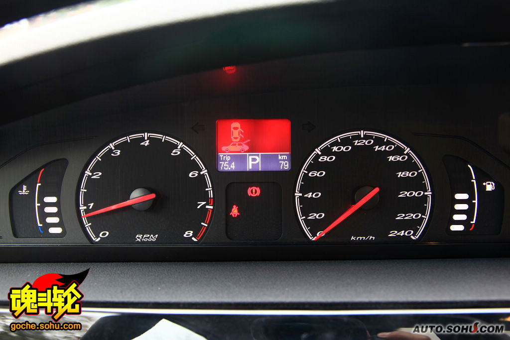

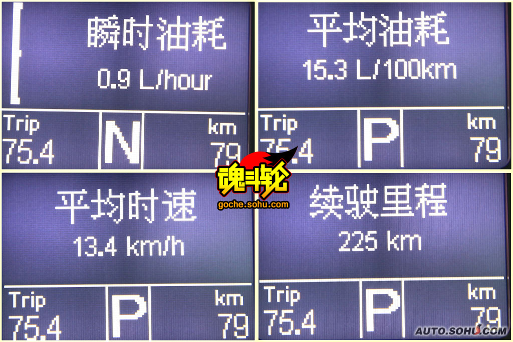

    Although the instrument sets the shape and 550 the same, but MG6 dial internal structure of a substantial change has taken place. Reasons based on style, MG6 using the traditional double-disc instruments, fuel and water temperature on the table to keep the style of 550 is still an electronic grid display.
    Start the engine, the instrument would all be self-test. In addition to the central traffic computer screen displays the total mileage of the fixed, gear information, can also rotate the steering wheel multi-function knob to the left of the instantaneous fuel consumption, average fuel consumption, endurance mileage, average speed display switching operation simple and convenient.
    Meanwhile, the piece of screen can also be displayed, such as doors or the trunk door is not closed, ESP off, maintenance alerts.
